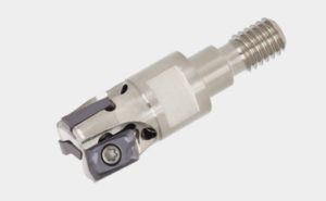

| Corps d’outil: | EPAV04M008C08.0R02 (ø8 mm, z=2) |
| Plaquette: | AVMT040204PPER-MM |
| Nuance: | AH3225 |
| Conditions de coupe: | Vc = 150 (m/min) fz = 0.08 (mm/t) Vf = 895 (mm/min) ap = 1.429 (mm) ae = 8 (mm) Application: Rainurage Liquide de refroidissement : jet d’air Machine: Vertical M/C, BT50 |

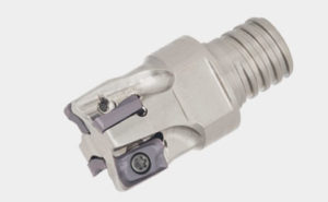

| Corps d’outil: | EPAV06M014C12.0R03 (ø14 mm, z=3) |
| Plaquette: | AVGT060302PBER-MJ |
| Nuance: | AH3225 |
| Conditions de coupe: | Vc = 264 (m/min) fz = 0.125 (mm/t) Vf = 1,500 (mm/min) ap = 6 (mm) ae = 3 (mm) Application: fraisage 90° Liquide de refroidissement : avec (externe) Machine: Vertical M/C, BT40 |

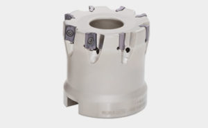

| Corps d’outil: | TPAV12M050B22.0R12 (ø50 mm, z = 12) |
| Plaquette: | AVGT120408PDFR-AM |
| Nuance: | KS05F |
| Conditions de coupe: | Vc = 950 (m/min) fz = 0.15 (mm/t) Vf = 11,000 (mm/min) ap = 6(mm) ae = 35 (mm) Application: fraisage de face Liquide de refroidissement : avec (externe) Machine: Vertical M/C, BT50 |
