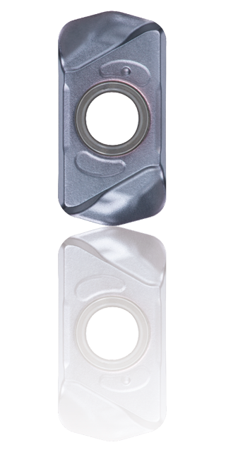

TungForce-Feed logo
Small-diameter high feed milling cutter with robust design
  • - Strong insert corner for high feed operations
  • - Maximum feed rate: 0.8 mm/z
  • - Tool diameters ø8 - ø16 mm
TungForce-Feed features

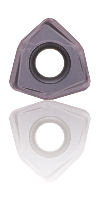

DoFeed logo
Versatility at its finest
  • - Perfect for ramping, plunging, hole enlarging, slotting, drilling, and shoulder milling in a wide range of industries.
  • - Smooth chip evacuation and minimal chattering.
  • - Easy machining on long overhang applications like large depth machining.
  • - Maximum feed rate: 1.5 mm/z
  • - Tool diameters ø16 - ø50 mm
DoFeed 03 features
