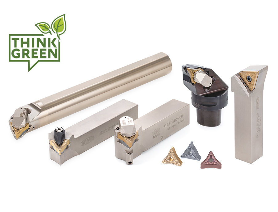

6-corner inserts for high versatility, economy and productivity
Front Turning, Back Turning, Profiling, and Face Turning with ONE SINGLE TOOL

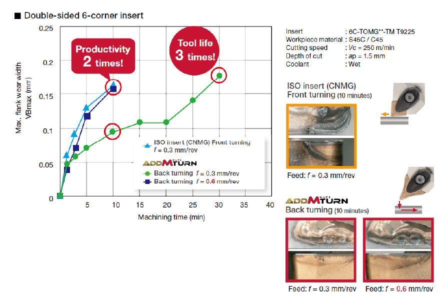

AddMultiTurn insert provided triple tool life when fed at the same feed rate as ISO insert.
Double the feed rate with AddMultiTurn compared with ISO insert without compromising tool life.
