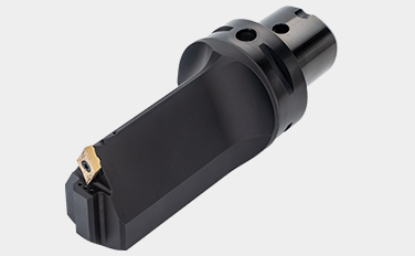

2. PSC Y-axis tool for multitasking machines
  • High rigidity design PSC tool body and through-coolant supply for tool life stability
3. Y-axis tooling concept providing small entry angle for high productivity

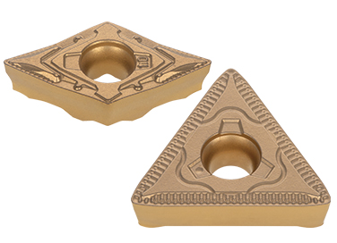

T-type for medium cutting operation
  • Thanks to its high-feed geometry, AddY-axisTurn insert provides high productivity
  • Y-axis tool orientation allows both sides of the cutting edge to be used, providing stable and long tool life

Inserts
AddY-axisTurn inserts
Main Grades
T9215
  • P10 – P20
  • Well-balanced between wear and chipping resistance
  • First choice for steel
  • High versatility for a wide range of applications

AddY-axisTurn Toolholders
Screw-on Y-axis turning toolholder with PSC connection
