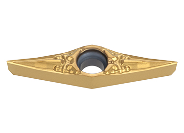

YCGT
  • Positive relief angle, G class, 25 deg corner angle insert

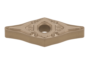

YNMG
  • Negative relief angle, M class, 25 deg corner angle insert

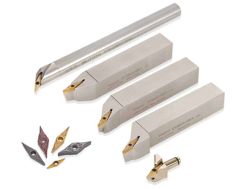

Toolholders
External turning
Y-Pro Series Toolholders
25° corner angle for profiling
Internal turning
