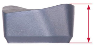

Strong and thick insert corner is designed to withstand fracturing force during high-feed operations.
Thick insert corner Max. 10% thicker than competitors
