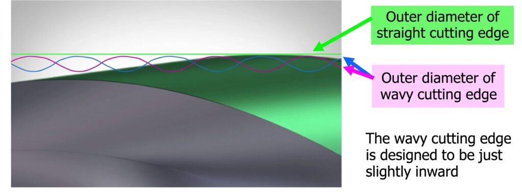

FinishMeister is a square end mill with a proprietary Combination Edge design featuring two types of cutting edges — roughing edges and finishing edges. The roughing edges reduce cutting resistance and create vibration cycle shifts that suppress the resonance that causes chatter, providing superior chatter suppression compared to conventional square end mills. Additionally, because the finishing edges protrude beyond the roughing edges, they handle wall surface finishing, delivering surface roughness and quality equivalent to conventional square end mills.
