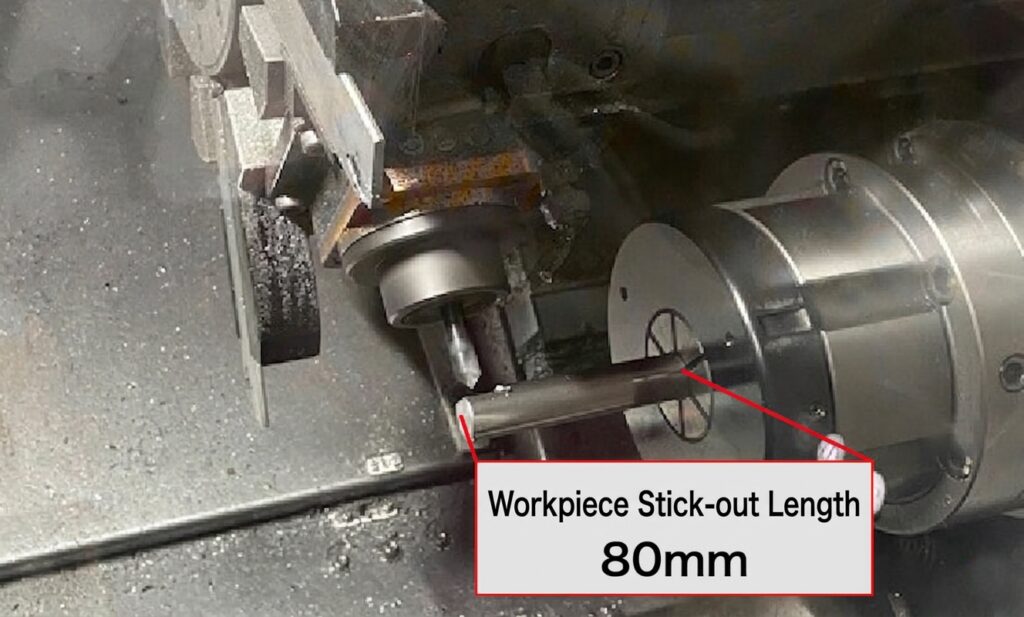

“The process I felt was especially problematic was this ‘spot drilling + chamfering’ process. Due to interference between the collet case gripping the workpiece and the rotary tool unit, as well as the machine’s milling range limitations, the workpiece needed to protrude approximately 80mm for milling operations. Moreover, since machining occurred near the end face, it had to be done in a cantilevered setup. With the workpiece in a low-rigidity state, machining became unstable. Chatter was particularly pronounced on smaller diameter belt pin models, resulting in chamfers with irregular hole shapes.”

NC Lathe with Bar Feeder and Sub-Spindle Used for Center Pin Machining
Bar feeder
View of “Spot Drilling” + “Chamfering” Process

“For the other bottleneck process—’spot drilling + chamfering’—I anticipated it would be a difficult improvement given the small-diameter workpiece and long overhang conditions. Since the exchangeable head tool TungMeister offers a wide variety of chamfering heads, I explored whether we could select the optimal head for belt pin machining from this lineup.”

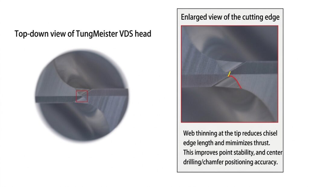

“I selected the VDS type expecting that its large helix angle and low-resistance design would be suitable for this application. Also, when I examined the competitor chamfering tools that Tsubakimoto Mayfran was using, none had thinning applied to the cutting edge. I thought that using the VDS type with its thinning feature would reduce thrust force, thereby suppressing workpiece deflection even on low-rigidity workpieces.”

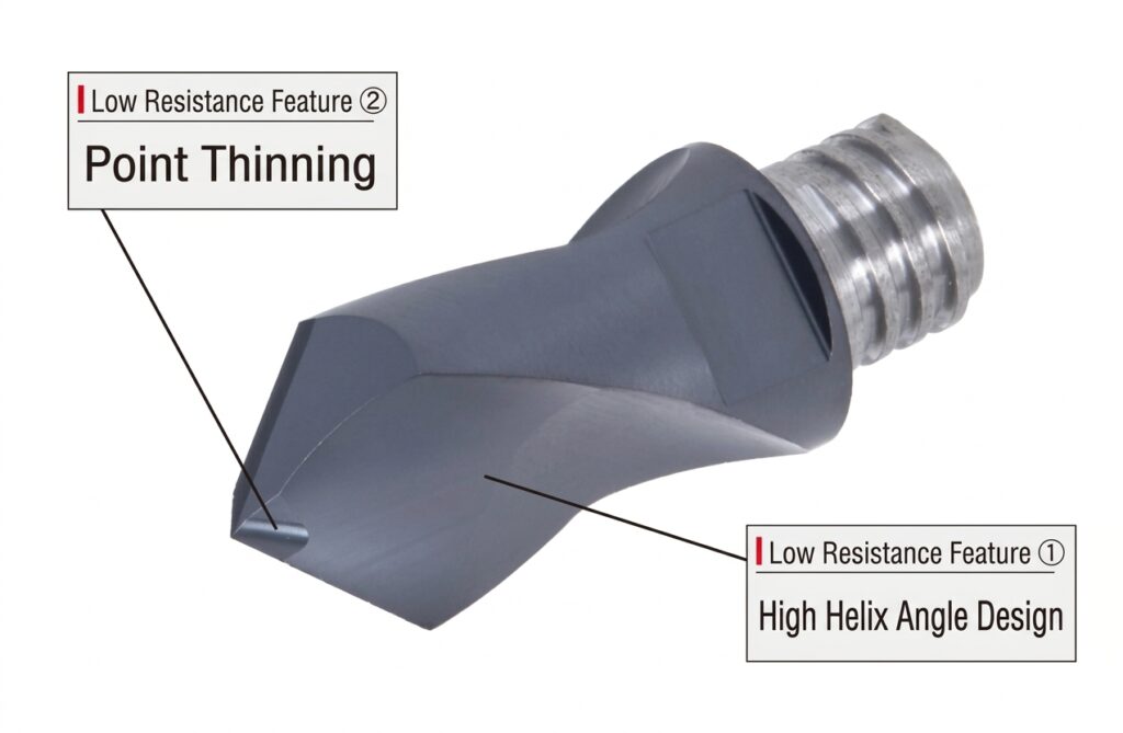

  3. TungMeister VDS Head
    Sharpness-Focused VDS Type (with center cutting edge)
Features of VDS Type
  1. Front View of VDS Head
  2. VDS Head

  1. Low-Resistance Chamfering Head VDS Type Used for “Spot Drilling” + “Chamfering” in Low Workpiece Rigidity Conditions — Achieved Stable Machining and Dramatically Improved Tool Life
    The VDS type head features a high helix angle design and thinned cutting edge geometry. It reduces cutting resistance and suppresses workpiece deflection, enabling stable machining even in low-rigidity conditions.
