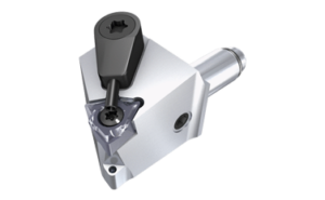

Economical double-sided positive insert
Innovative geometry and seat interface ensures stability and high performance
Applications & Features
Internal turningExternal turning
1. Economical double-sided positive insert
WXGU
DXGU
VXGU
CXMU
DXMU
2. Toolholders
3. Light cutting chipbreaker
  • JS chipbreaker – features and benefits
    • Provides excellent chip control in a wide range of applications.
    • A large inclination angle on the cutting edge ensures free cutting.
    • Excellent cutting edge integrity for smooth surface finishing.
    • Note: Due to chipbreaker profile, max ap for face or ID turning is 1 mm.

WX-U inserts
  • 6 positive cutting edges
DX-U Inserts
  • 4 positive cutting edges
VX-U Inserts
CX-U inserts
