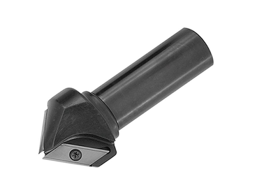

Chamfer mill featuring a screw clamp system and large parallelogram inserts
Indexable chamfer mill that covers a large range of diameters.
Applications & Features

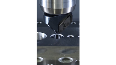

ChamferingHole chamfering
Indexable chamfer mill to improve productivity
1. Chamfer mills offered in angles of 30°, 41°, 45°, and 60°
2. Supports plunge and interpolated chamfering across a wide range of hole diameters
3. Ability to cut large chamfers along a profile

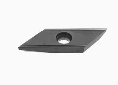

Inserts
XCET31
Grades
AH3135
  • High fracture resistance
AH330
  • Excellent wear resistance
AH120
  • Suitable for machining steel, stainless steel, and cast iron under general cutting conditions
NS740
  • High resistance to fracture and thermal crack
  • High-rigidity grade for milling

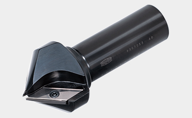

Toolholders
Shank Type
ECC31
Indexable chamfering cutter with large parallelogram insert

  • When the hole diameter to be chamfered is small or the cutting edges near the front end of the tool are used, use the higher side of the RPM range shown in the table.
    In contrast, when the hole diameter to be chamfered is large or the cutting edges far from the tool’s front end are used, use the lower side of the RPM range shown in the table.
  • When chamfering a small diameter hole (smaller than ø0.394″ (ø10 mm)) in a plunge milling mode, peck-feeding should not be used.
  • When the hole diameter to be chamfered is smaller than ø0.394″ (ø10 mm) or the cutting edges near the tool’s front end are used, the feed should be set within 0.006 ipt (0.15 mm/t).
