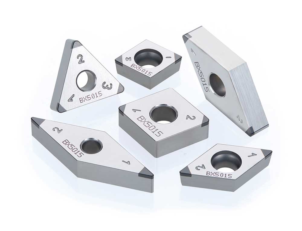

New CBN Grade for Gray Cast Iron
New CBN grade developed for low-speed machining of gray cast iron
Applications & Features
Internal turningExternal turning
1. Application areas
2. Grade properties
– By incorporating a binder with excellent heat and oxidation resistance, BX5015 exhibits superior wear resistance during the low-speed machining of gray cast iron.
– The uniform distribution of sub-micron CBN grains within the binder phase provides BX5015 with excellent fracture resistance.
Grades
BX5015
  • Delivers excellent performance in lowspeed machining of gray cast iron.
