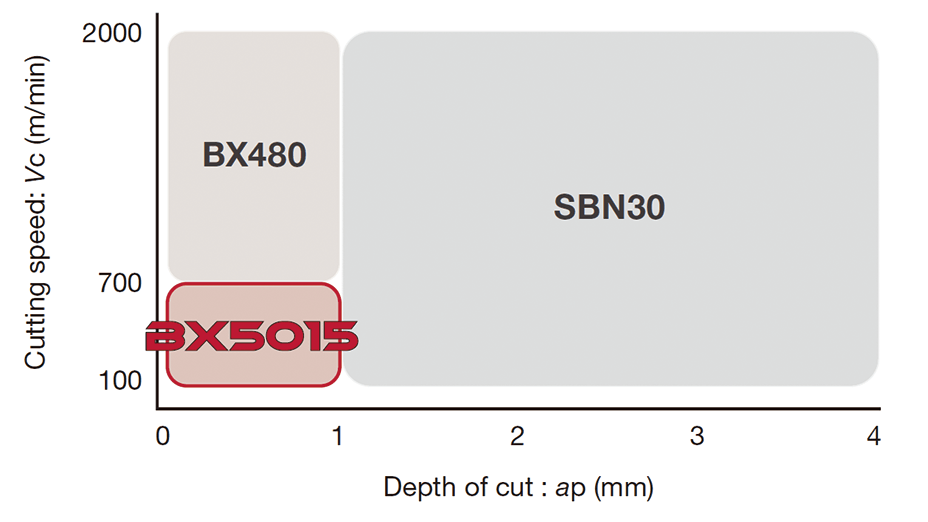

Gray cast iron, which is widely used for automotive and agricultural machinery components, requires high wear resistance and dimensional accuracy, making machining stability a critical factor. In particular, large workpieces such as oil pump housings and flywheel housings are structurally limited in chuck clamping strength, making high-speed rotation difficult; therefore, low-speed turning is generally employed. However, conventional CBN grades have been designed primarily for high-speed machining performance, and thus have faced challenges such as short tool life and insufficient stability in low-speed ranges. As a result, there is a growing demand for new CBN grades that can achieve both long tool life and high-quality surface finish even under low-speed machining conditions.
Product Overview

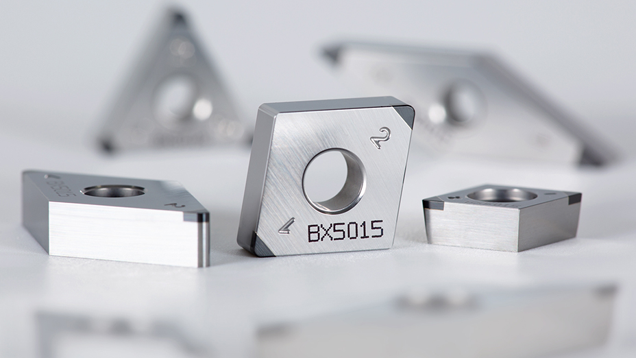

BX5015 is a new CBN grade engineered for extended tool life and stable performance in gray cast iron machining. Combining outstanding wear resistance with excellent fracture resistance, it delivers reliable machining across a broad range of cutting conditions, from low-speed operations to interrupted cuts.

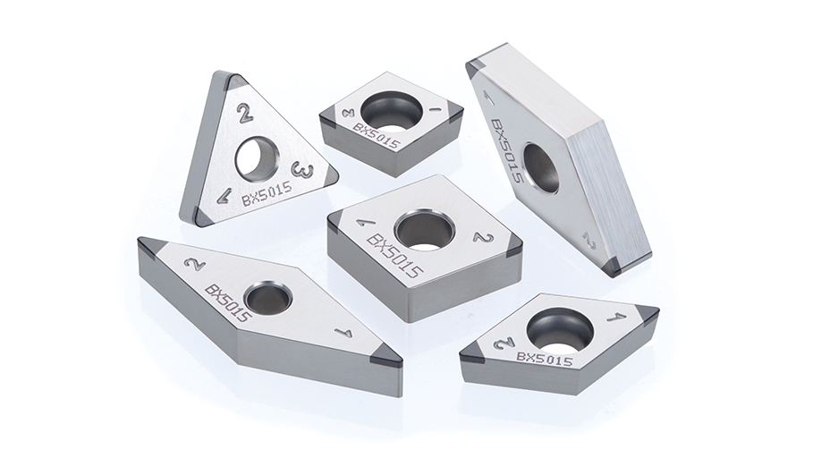

Feature 3: Versatile lineup for a wide range of applications
– The new grade BX5015 is available in 25 items, enabling compatibility with various machining conditions and shape requirements.

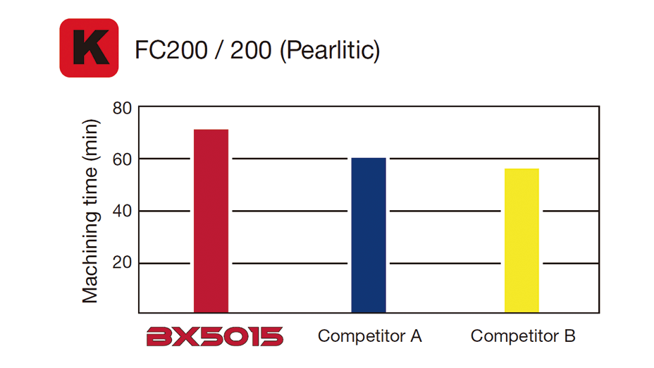

Cutting Performance
| Insert | CNGA120408 |
| Cutting speed | Vc = 500 m/min |
| Feed | f = 0.2 mm/rev |
| Depth of cut | ap = 0.2 mm |
| Machining | Interrupted cutting |
| Coolant | Wet |
BX5015 achieves superior wear resistance in low-speed continuous machining of gray cast iron.

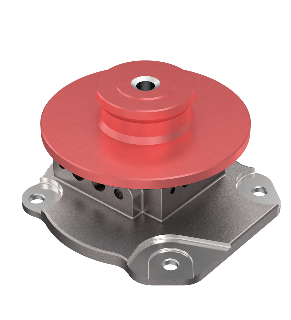

Despite cutting speed limitations caused by the irregular shape and height of the workpiece, BX5015 delivered double the tool life of the competitor through excellent low-speed wear resistance.
| Industry | Aotomotive |
| Component | Bearing housing |
| Material ISO code | |
| Work material | FC250/250 |
| Machine(Spindletype) | CNC Lathe |
| Toolcategory | External & Face turning |
| Product name | BX5015 |
| TSR No. | 5607T |
