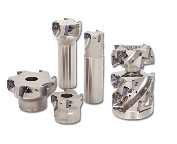

Shoulder milling cutter with cost-efficient inserts and outstanding chatter stability
Economical 3 cutting-edge insert with large rake angle on cutting edge reduces cutting force and provides excellent chip formation
Optimized flank face on insert and differential pitch on cutter prevent chatter in machining

Cutter bodies
Shank Type
EPA04/06/10/15 (ø8 – ø50 mm)
Cylindrical type holder for shoulder milling
Modular Type
HPA06-M (ø16 – ø32mm)
Modular head (TungFlex) for shoulder milling
Bore Type
TPA06/10/15 (ø32 – ø160 mm)
Bore type for shoulder milling
Bore Type
TLA series / C-EPA
Long depth of cut shoulder milling / TUNGCAP type
