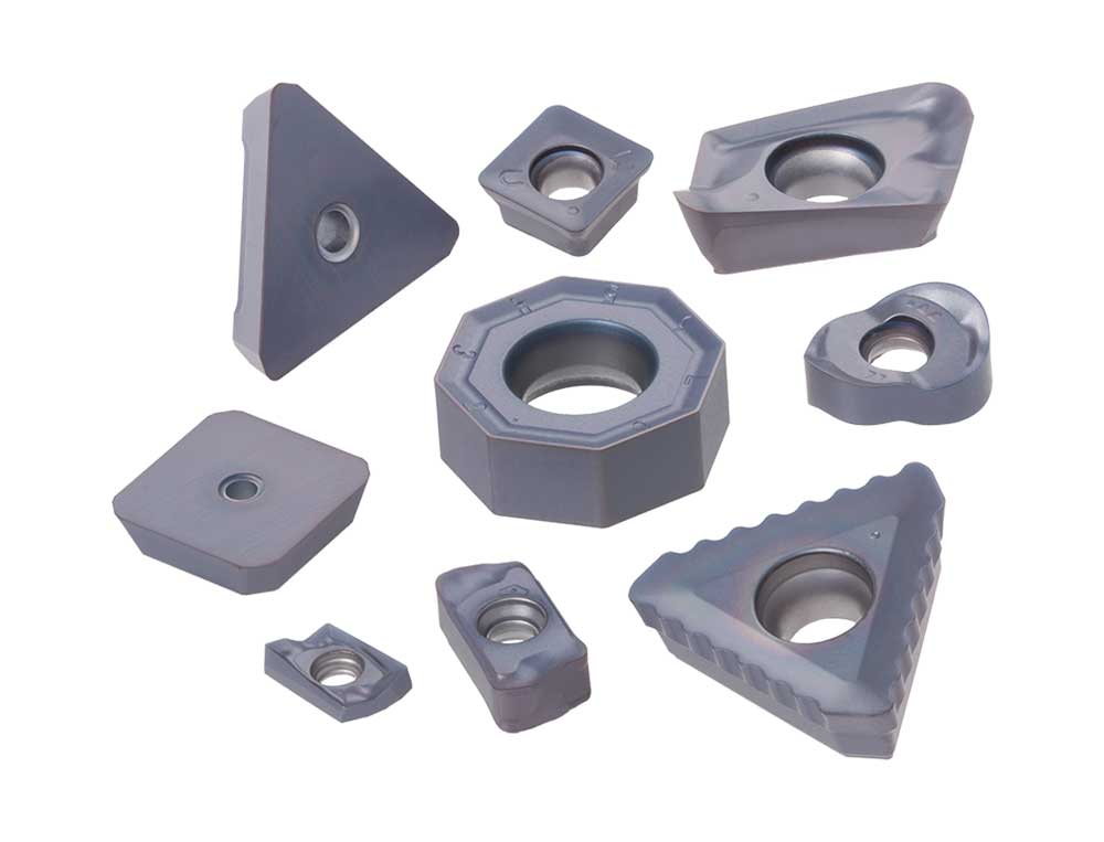

PVD grade for steel and stainless steel with excellent combination of wear and fracture resistance.
First choice grade in steel for long tool life and process reliability
Applications & Features
Face millingShoulder millingShoulder milling RSlottingSlotting RSide millingPocketingRampingProfilingPlungingHole enlargingHolemakingCounterboring
– Nano multi-layer coating technology with three major properties for optimal cutting edge integrity
– Increased resistance to wear, fracture, oxidation, built-up edge, and delamination
Main Grades
AH3225
  • Suitable for steel and stainless steel
