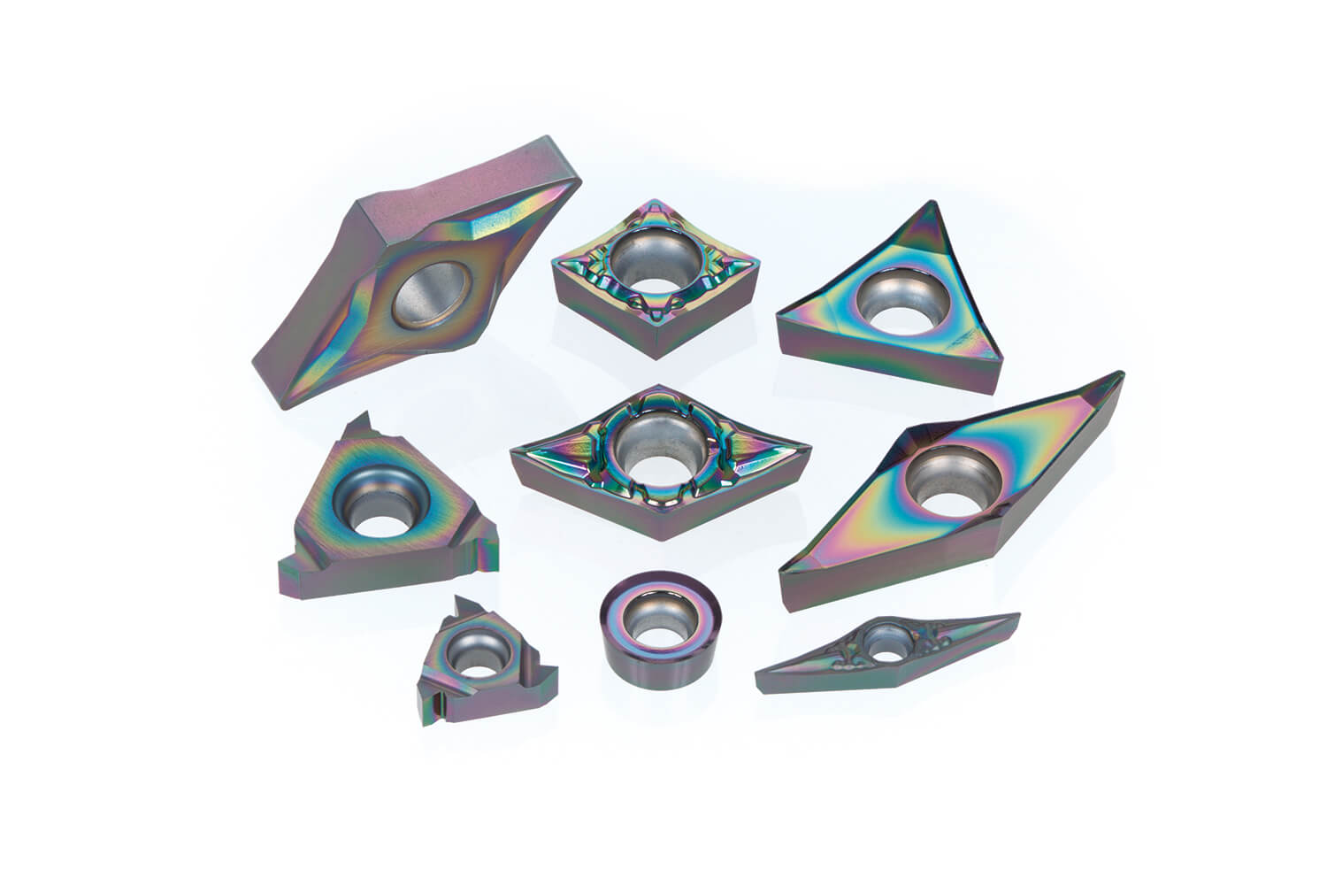

Iwaki, Japan – June, 2026 – Tungaloy Corporation (President: Satoshi Kinoshita, Head Office: Iwaki City, Fukushima Prefecture) announces the expansion of its lineup of products featuring the DS2000 Series, DLC-coated grades designed for machining non-ferrous metals such as aluminum alloys. The expansion includes inserts with JS-type and JP-type chipbreakers, which provide excellent chip control in precision machining and small-part machining, in addition to the first-choice AL-type chipbreaker, as well as threading inserts.

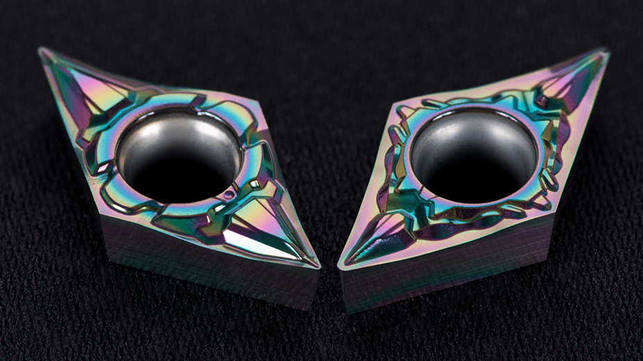

The DS2000 Series is a grade for machining non-ferrous metals that features Tungaloy’s proprietary DLC coating. With its excellent resistance to welding, the DS2000 Series suppresses the formation of built-up edges, while its high coating adhesion significantly reduces coating delamination. In addition, the coating’s high hardness and excellent heat resistance help slow the progression of cutting-edge wear, resulting in longer tool life. As a result, the DS2000 Series delivers stable machining performance in a wide range of non-ferrous metal applications, including aluminum alloys.

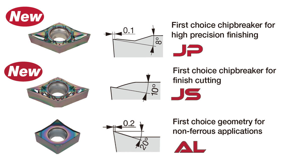

Feature 1: JS and JP-type Chipbreakers Supporting High-Precision Machining

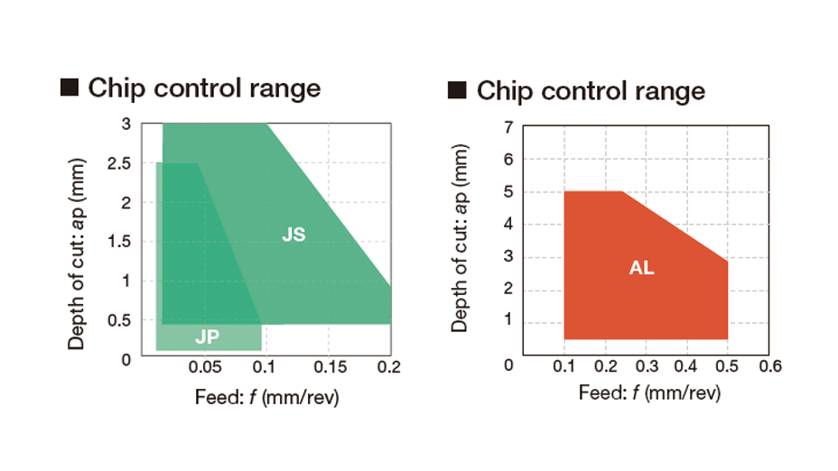

– The G-class 3D breaker design optimizes chip flow and ensures stable chip control.
– The unique protrusion geometry delivers excellent chip evacuation even under small depth of cut and low feed conditions.
– From finishing to precision finishing, it provides consistently superior surface quality in small-part machining.
Feature 2: First-Choice AL-type Chipbreaker for Non-Ferrous Metal Machining
– Achieves low cutting force with a large rake angle and sharp cutting edge.
– Provides excellent chip control through a large inclination angle cutting edge geometry and optimized chipbreaker design.
– Delivers superior resistance to built-up edge thanks to the combination of a mirror-finished rake face and DLC coating, enabling high-quality machined surface finishes.

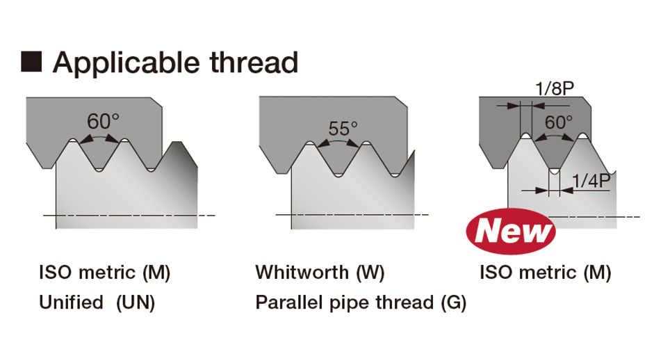

Feature 3: Inserts with Finishing Edge for High-Precision Thread Machining
– The finishing-edge design compliant with ISO metric threads improves thread profile accuracy.
– Reduces adhesion, ensuring gloss and dimensional stability of thread surfaces.
– With stable tool life characteristics, it provides high reliability even in continuous production lines.

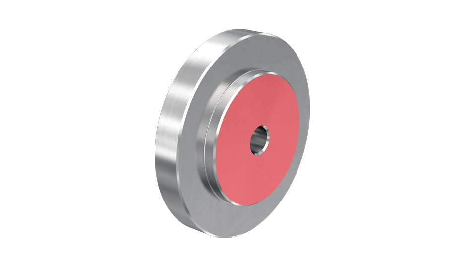

| Industry | Semiconductor |
| Component | semiconductor manufacturing equipment parts |
| Material ISO code | |
| Work material | ADC12 |
| Machine(Spindletype) | CNC Lathe |
| Toolcategory | Face turning |
| Product name | DS2000 |
| TSR No. | 5597T |
