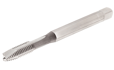

Point Tap
TP-**
- M – ISO metric coarse thread
- MF – ISO metric fine thread
- UNC – ISO Unified coarse thread
- UNF – Unified fine thread

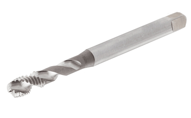

Spiral Tap
TS-**

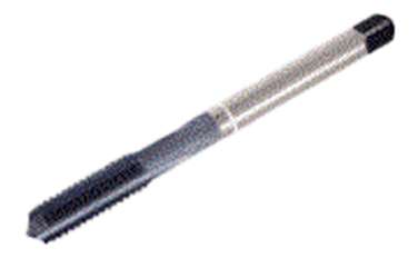

HB070
- The steam tempered is a Fe3O4 oxide coating which reduces the friction between the tool and workpiece and prevents cold welding.

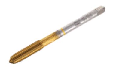

- The TiN coating has a hardness of approximately 2,300 HV and is temperature resistant up to approximately 600°C. This is an excellent golden colored coating for general applications.
GB070
