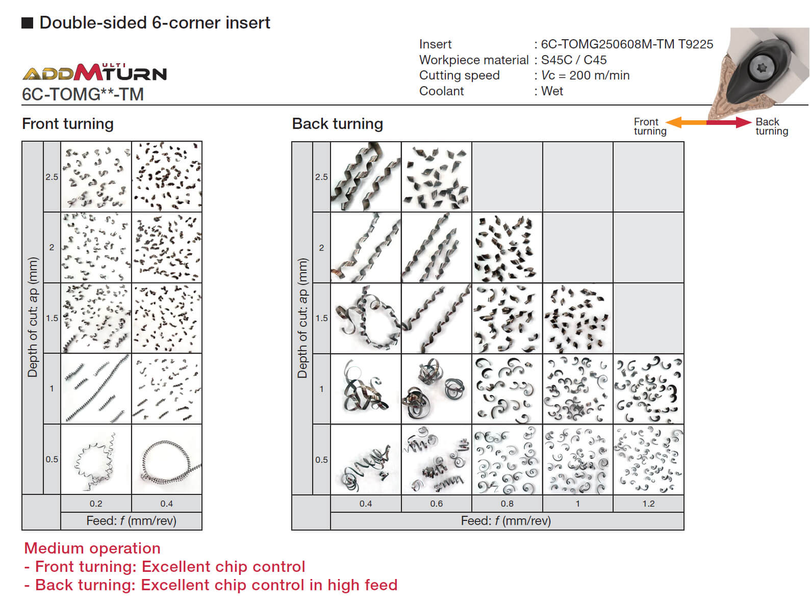

Insert: | 6C-TOMG250608M-TM |
Grade: | T9215 |
Cutting conditions: | Vc = 147 (m/min) Face turning: f = 0.35 (mm/rev) ap = 1 – 2 (mm) External turning: f = 0.5 (mm/rev) ap = 0.5 (mm)Coolant: Wet (External coolant) Application: Face turning, External turning |

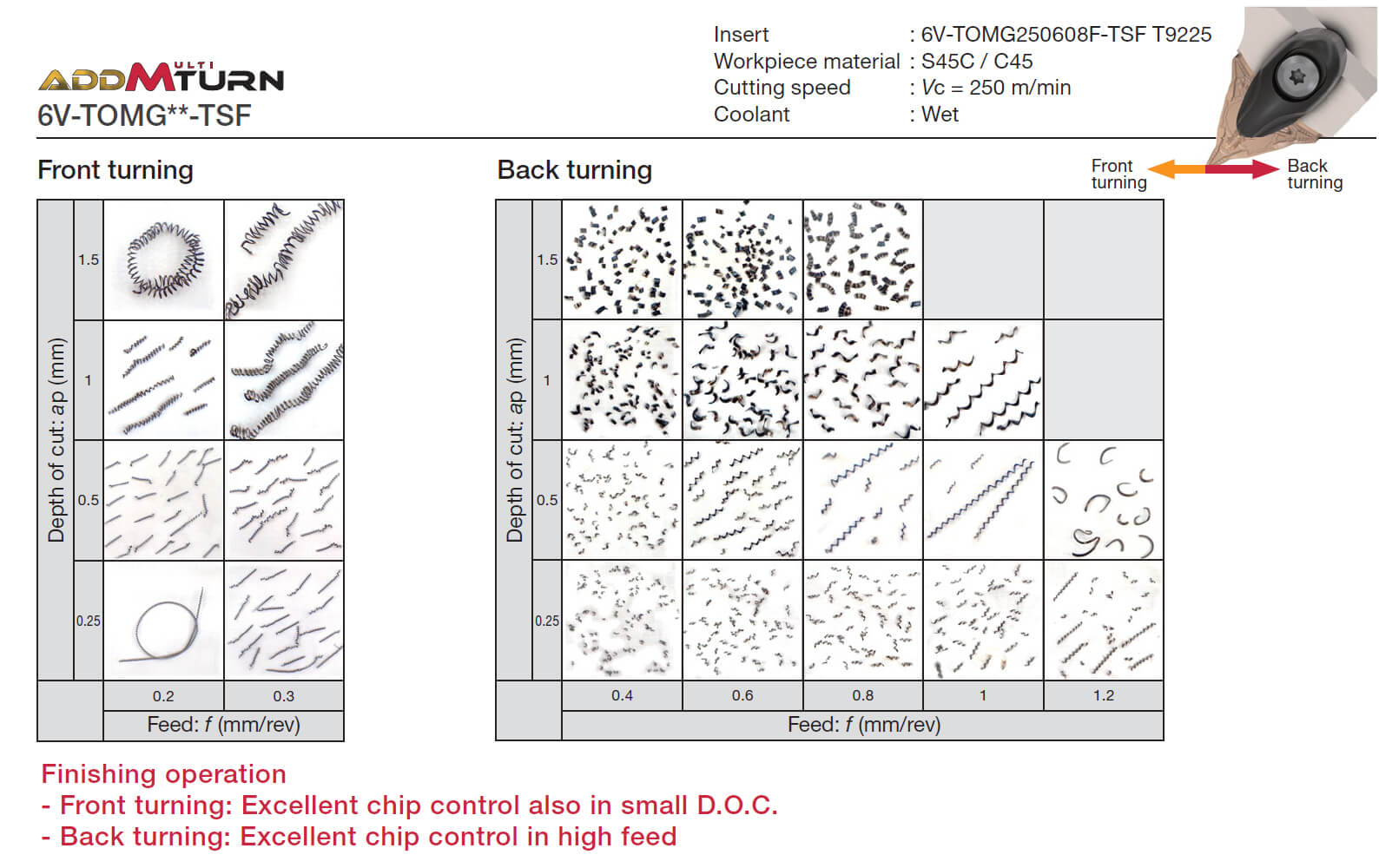

Insert: | 6V-TOMG250604F-TSF |
Grade: | T9215 |
Cutting conditions: | Vc = 200 (m/min) Roughing : f = 0.6 (mm/rev) x 2 passes Finishing : f = 0.1 (mm/rev) x 1 pass ap = 0.5 (mm) x 3 passesCoolant: Wet (External coolant) Application: External turning |
Standard cutting conditions
ISO | Operation | Chipbreaker | Grade | Depth of cut: ap (mm) | Feed: f (mm/rev) | Cutting speed | ||
Front turning | Back turning | Front turning | Back turning | Vc (m/min) | ||||
Finishing | TSF | T9215 | 0.2 – 1.5 | 0.2 – 1.5 | 0.08 – 0.4 | 0.2 – 1.2 | 150 – 400 |
TSF | T9225 | 0.2 – 1.5 | 0.2 – 1.5 | 0.08 – 0.4 | 0.2 – 1.2 | 80- 300 | ||
Medium to heavy cutting | TM | T9215 | 0.5 – 2.5 | 0.5 – 2.5 | 0.2 – 0.6 | 0.4 – 1.2 | 150 – 400 | |
TM | T9225 | 0.5 – 2.5 | 0.5 – 2.5 | 0.2 – 0.6 | 0.4 – 1.2 | 80 – 300 | ||
